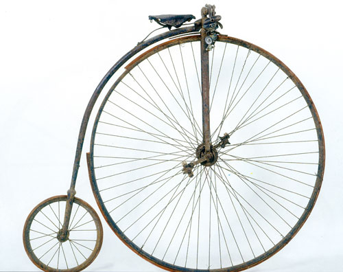

Messagede seb » 08 Avr 2011, 16:34
VELOCIPEDE :mrgreen:
a++++++
